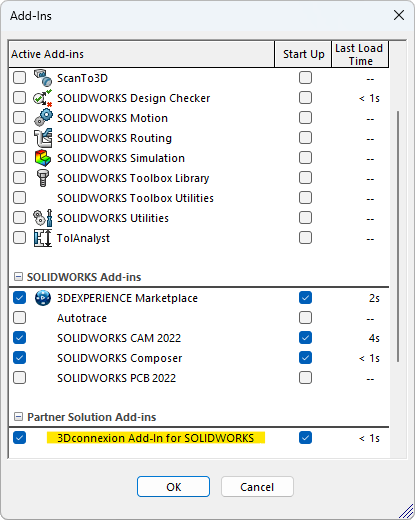

In case the driver could not connect to the Add-In for SOLIDWORKS the 3Dconnexion devices will not work.
In order to resolve the situation:
  1. Ensure the „3Dconnexion Add-In for SOLIDWORKS” was installed during installation of the driver
  2. Ensure the „3Dconnexion Add-In for SOLIDWORKS” is Active in SOLIDWORKS under „Tools > Add-Ins”
SOLIDWORKS AddIns
If this does not help, please get in touch with our Technical Support.
