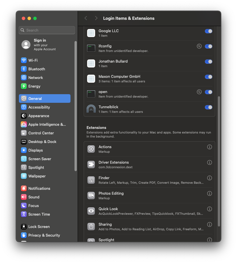

For macOS 15 (Sequoia) or Newer:

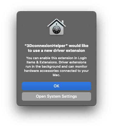

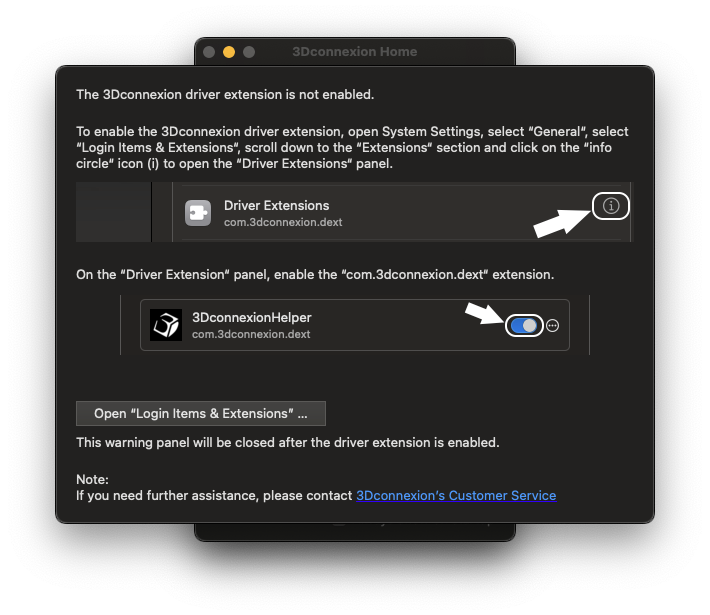

  1. After installation is complete, you will see a prompt with instructions on enabling the extension.
  2. Open System SettingsGeneralLogin Items & Extensions.
  3. Click the “i” icon next to Driver Extensions.

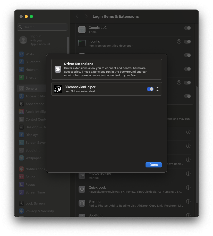

  4. In the new panel, activate the 3DconnexionHelper extension.

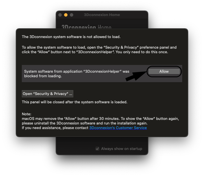

  1. After installation is complete, you will see two prompts with information about an extension requiring to be enabled. A system information “System Extension Blocked” with a house icon and a more detailed panel overlayed of “3D Mouse Home”.

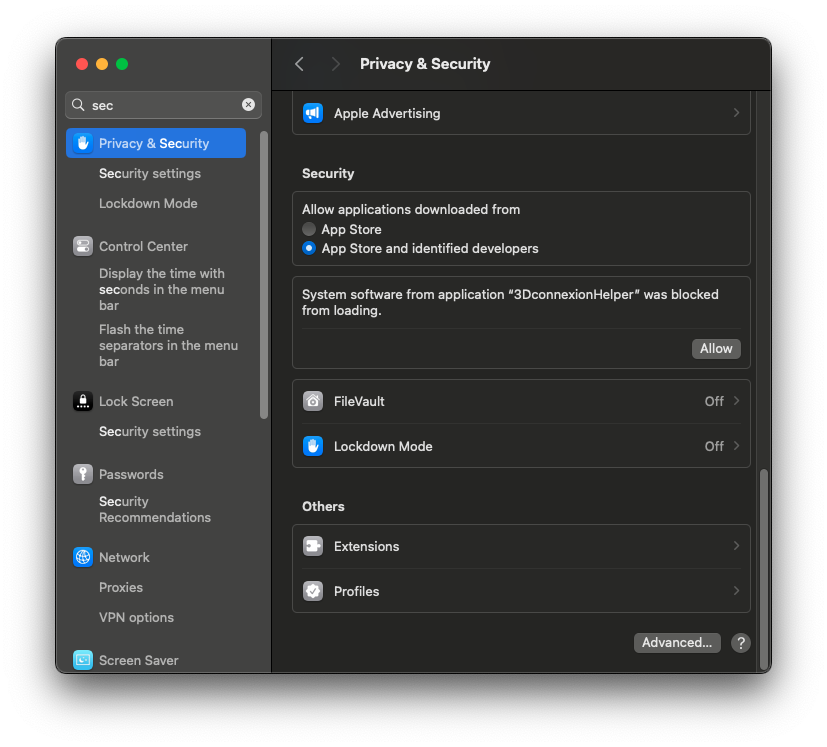

  2. Open System SettingsPrivacy & Security.
  3. Scroll down to find the message: “System software from the application ‘3DconnexionHelper’ was blocked from loading.”
  4. Click the Allow button.
