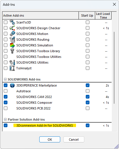

  1. Ensure the “3Dconnexion Add-In for SOLIDWORKS” was installed during installation of the driver
  2. Ensure the “3Dconnexion Add-In for SOLIDWORKS” is Active in SOLIDWORKS under “Tools > Add-Ins”
SOLIDWORKS AddIns
