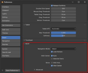

  1. Click “Edit” button on the ribbon and select “Preferences“
  2. Select the “Input” category and scroll to the “NDOF” tab at the bottom of the window. Here, you can configure most settings related to the SpaceMouse.

How do I enable “Fly Mode”?
Blender 4.5:
  1. Under “NDOF Preferences”, set “Navigation mode” option to “Fly“
Blender 4.4 and previous:
  1. Under “NDOF Preferences”, set “Navigation” option to “Free“
  2. Deselect all axes in the “Invert Axis Pan” and “Orbit” fields, to ensure the reversal of axes is disabled for a true Fly Mode experience
How do I enable “Object Mode”?
Blender 4.5:
  1. Under “NDOF Preferences”, set “Navigation mode” option to “Object“
Object Mode is the default navigation method in Blender, but if you need to reenable it:
  1. Under “NDOF Preferences”, set “Navigation” option to “Orbit“
  2. Select all axes in the “Invert Axis Pan” and “Orbit” fields, to ensure the reversal of axes is enabled
