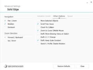

Move Selected Objects: Enables or disables the independent movement of sub-parts within an assembly.
Scroll Tree Views: Allows the SpaceMouse to scroll (vertically and horizontally) any tree or list view under the mouse pointer.
Check for Collision: Activates collision detection in Solid Edge when manipulating a component with the SpaceMouse.
Zoom to Cursor: Allows the SpaceMouse to zoom in to where the traditional mouse is pointing. Press the middle mouse button and move the SpaceMouse Controller Cap forward and backward parallel to the desk to activate fast zooming mode.
Draft: Move Drawing Views on Select: Allows the SpaceMouse to move any selected Drawing View. This setting is enabled by default.
Draft: Z / Y Change: Allows to swap the Y and Z coordinates. This option is disabled by default and is useful if the display is a horizontal screen.
Draft: Keep Scale Constant: Stops the SpaceMouse from changing the scale of a draft view during manipulation. To increase or decrease the size of the drawing view, this option must be disabled. This setting is enabled by default.
Sketch / Profile: Disable Rotation: When selected, it disables rotation in Sketch mode. The SpaceMouse movement will be limited to zooming. This option is disabled by default.
