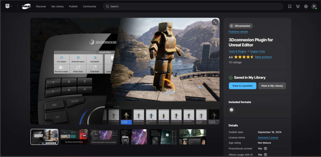

Starting with Unreal Editor version 5.4, the 3Dconnexion Plugin is no longer distributed through the 3DxWare 10 but directly through Fab.
To activate the Plugin, please follow these steps:
    1. Go to Fab.
    2. Click “Add to My Library” and then “View in Launcher.”.
    3. In the Epic Games Launcher, find the “3Dconnexion Plugin for Unreal Editor” in the “Fab Library” – you may need to refresh it.
    4. Click “Install to Engine” and pick your Unreal Engine version.
    5. Open Unreal Engine and your project.
    6. Go to Edit → Plugins, enable “3DxUnreal”, and restart Unreal if prompted.
    7. After restarting, you’re ready to use SpaceMouse in Unreal Editor!
