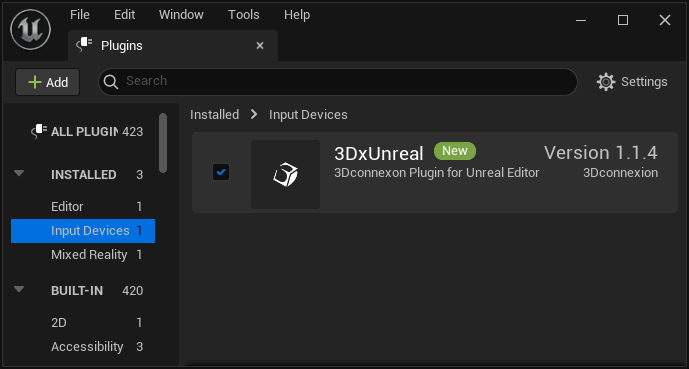

You can confirm if the plugin is enabled in the “Plugins” panel (menu Edit > “Plugins…”) under the “Input Devices” category.

After copying the directory, start Unreal Editor and confirm if the plugin is enabled in the “Plugins” panel (menu Edit > “Plugins…”) under the “Input Devices” category. Restart Unreal Editor if prompted.
