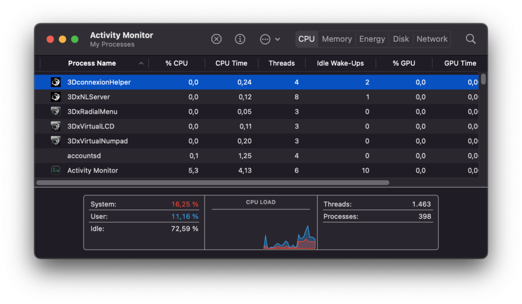

After that, you can confirm it is running in the process list in the activity monitor:
Finder > Applications > Utilities > Activity Monitor

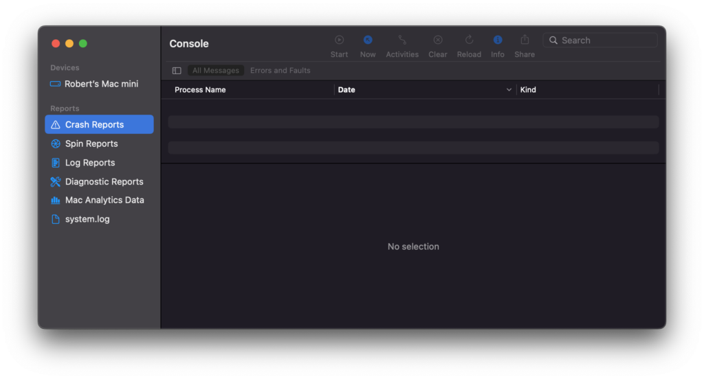

In case 3DconnexionHelper keeps disappearing (crashing), please contact our technical support and send us the corresponding Crash Reports which can be found in the console:
Finder > Applications > Utilities > Console > Crash Reports
