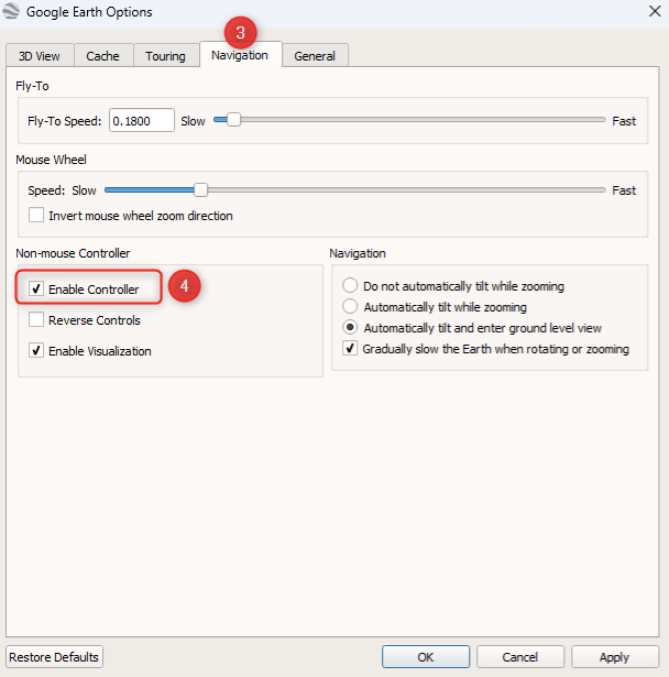

In Google Earth Desktop the support for the SpaceMouse is not enabled by default. You have to enable it manually:
  1. Open Google Earth Pro
  2. Go to Tools – Options
  3. Open the “Navigation” tab
  4. Activate the option: “Enable Controller” in the “Non-mouse Controller” section
