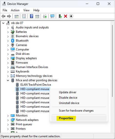

  1. Open “Device Manager” and open the “Properties” of your CadMouse:

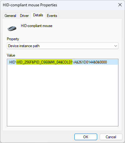

  2. Click on the Details tab and note down the “VID ID” value for the mouse — in this example “VID_256F&PID_C668&MI_04&COL01”

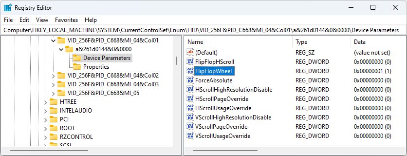

  1. Open the registry editor and browse to HKEY_LOCAL_MACHINE\SYSTEM\CurrentControlSet\Enum\HID
  2. Expand the folder (key) that matches the “VID ID” from Step 1 to “Device Parameters”

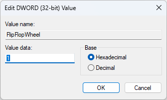

  3. Double-click the FlipFlopWheel DWORD and set the value from 0 to 1
