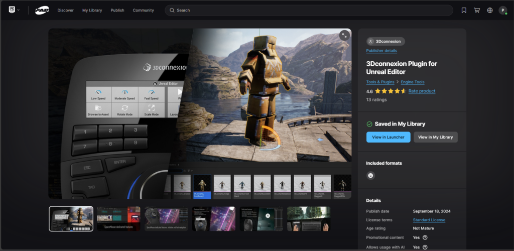

1. Installing the Plugin
Starting with Unreal Editor version 5.4, the 3Dconnexion Plugin is no longer distributed through the 3DxWare 10 but directly through Fab.
To activate the Plugin, please follow these steps:
    1. Go to Fab.
    2. Click “Add to My Library” and then “View in Launcher.”.
    3. In the Epic Games Launcher, find the “3Dconnexion Plugin for Unreal Editor” in the “Fab Library” – you may need to refresh it.
    4. Click “Install to Engine” and pick your Unreal Engine version.
    5. Open Unreal Engine and your project.
    6. Go to Edit → Plugins, enable “3DxUnreal”, and restart Unreal if prompted.
    7. After restarting, you’re ready to use SpaceMouse in Unreal Editor!
