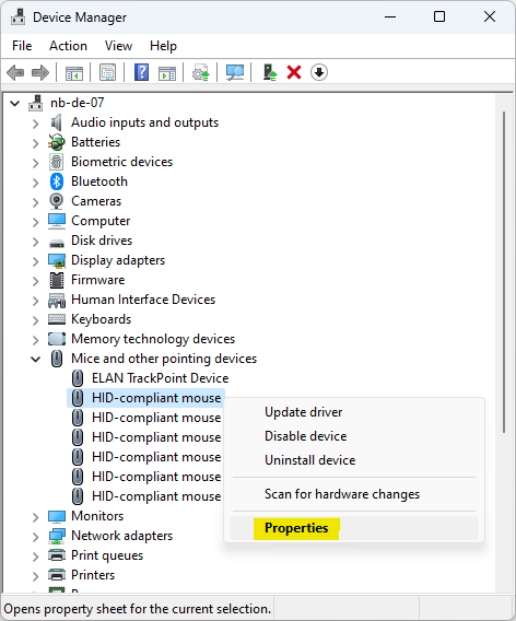

  1. Open „Device Manager“ and open the „Properties“ of your CadMouse:

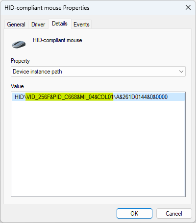

  2. Click on the Details tab and note down the „VID ID“ value for the mouse — in this example „VID_256F&PID_C668&MI_04&COL01“
    Note:  General VIDs and PIDs of 3Dconnexion products are listed here.

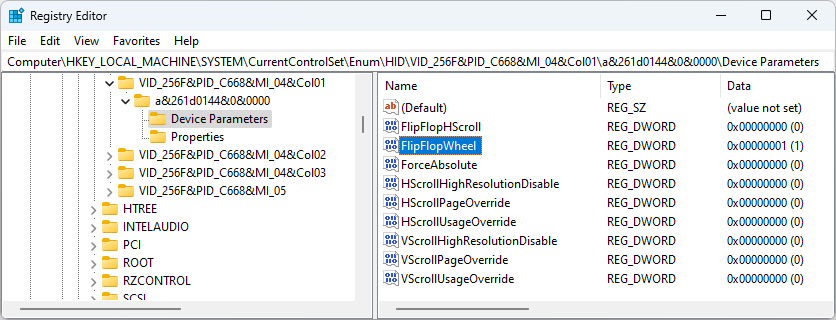

  1. Open the registry editor and browse to HKEY_LOCAL_MACHINE\SYSTEM\CurrentControlSet\Enum\HID
  2. Expand the folder (key) that matches the „VID ID“ from Step 1 to „Device Parameters“
  3. Double-click the FlipFlopWheel DWORD and set the value from 0 to 1
  4. Reboot
