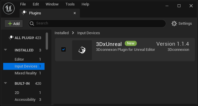

You can confirm if the plugin is enabled in the „Plugins“ panel (menu Edit > „Plugins…“) under the „Input Devices“ category.

After copying the directory, start Unreal Editor and confirm if the plugin is enabled in the „Plugins“ panel (menu Edit > „Plugins…“) under the „Input Devices“ category. Restart Unreal Editor if prompted.
