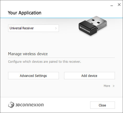

- Make sure the latest driver is installed.
- Connect the Universal Receiver to your computer.
- Select the Universal Receiver from the properties panel, click on „Add Device“ and follow the instructions.
Note:
You may also launch the pairing tool directly by clicking Start > Programs > 3Dconnexion > 3Dconnexion Pairing
