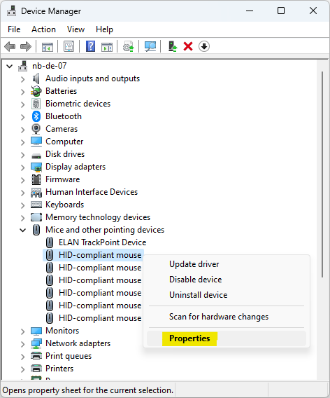

- Open „Device Manager“ and open the „Properties“ of your CadMouse:

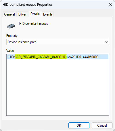

- Click on the Details tab and note down the „VID ID“ value for the mouse — in this example „VID_256F&PID_C668&MI_04&COL01“
Note: General VIDs and PIDs of 3Dconnexion products are listed here.

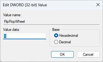

- Open the registry editor and browse to
HKEY_LOCAL_MACHINE\SYSTEM\CurrentControlSet\Enum\HID - Expand the folder (key) that matches the „VID ID“ from Step 1 to „Device Parameters“
- Double-click the FlipFlopWheel DWORD and set the value from 0 to 1
- Reboot
