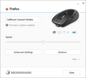

A notification will be displayed under the name of the device if a firmware is available (if you don’t see your device, please connect it via cable). See pictures below:

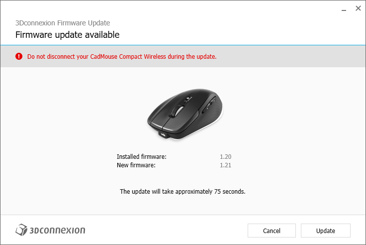

Clicking on the notification in the settings window starts the firmware update tool.
Please follow the instructions and click on Update.
In case you encounter any issues, please contact our Technical Support Team.
