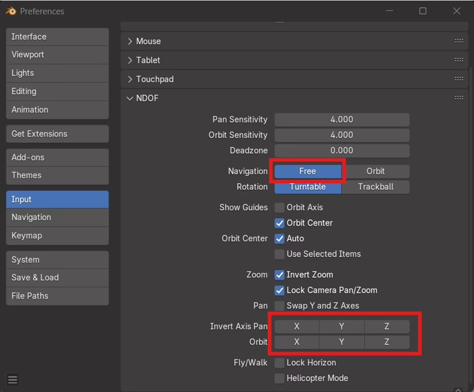

How do I enable Fly Mode?
Blender 4.5:
  1. Under “NDOF Preferences”, set “Navigation mode” option to “Fly
Blender 4.4 and previous:
  1. Under “NDOF Preferences”, set “Navigation” option to “Free
  2. Deselect all axes in the “Invert Axis Pan” and “Orbit” fields, to ensure the reversal of axes is disabled for a true Fly Mode experience

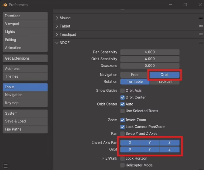

How do I enable “Object Mode”?
Blender 4.5:
  1. Under “NDOF Preferences”, set “Navigation mode” option to “Object
Object Mode is the default navigation method in Blender, but if you need to reenable it:
  1. Under “NDOF Preferences”, set “Navigation” option to “Orbit
  2. Select all axes in the “Invert Axis Pan” and “Orbit” fields, to ensure the reversal of axes is enabled
