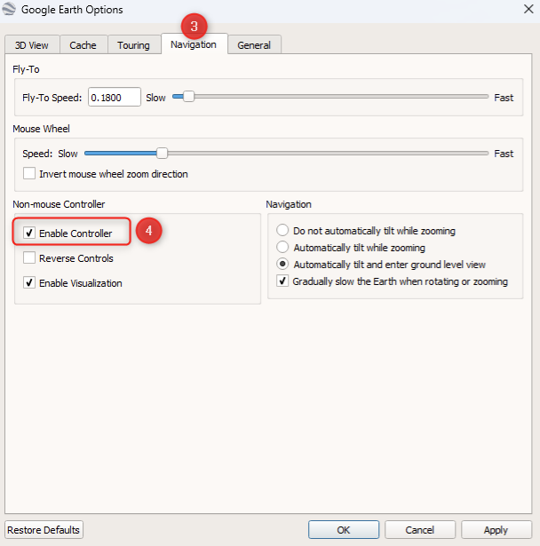

In Google Earth Desktop the support for the SpaceMouse is not enabled by default. You have to enable it manually:
- Open Google Earth Pro
- Go to Tools – Options
- Open the “Navigation” tab
- Activate the option: “Enable Controller” in the “Non-mouse Controller” section
