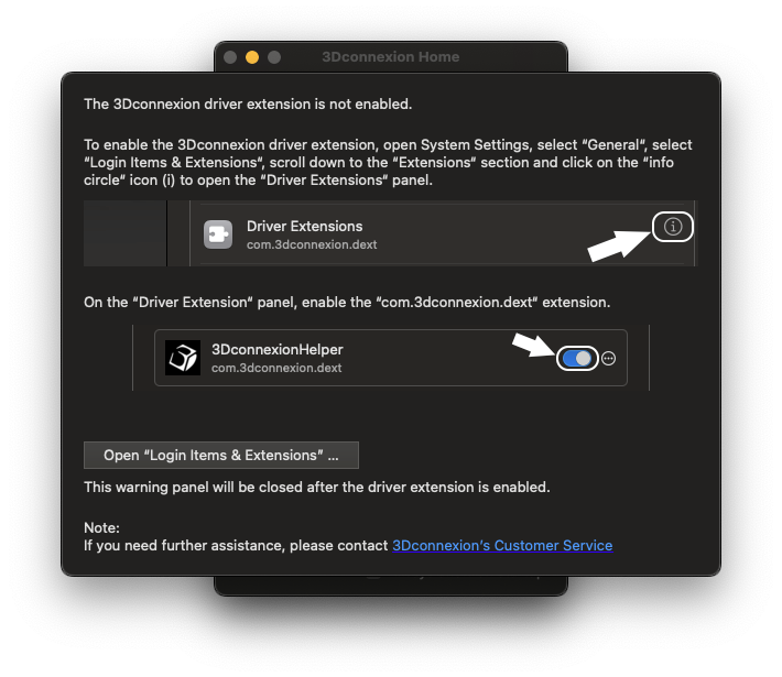

For macOS 15 (Sequoia) or Newer:
  1. After installation is complete, you will see a prompt with instructions on enabling the extension.
  2. Open System SettingsGeneralLogin Items & Extensions.
  3. Click the “i” icon next to Driver Extensions.
  4. In the new panel, activate the 3DconnexionHelper extension.

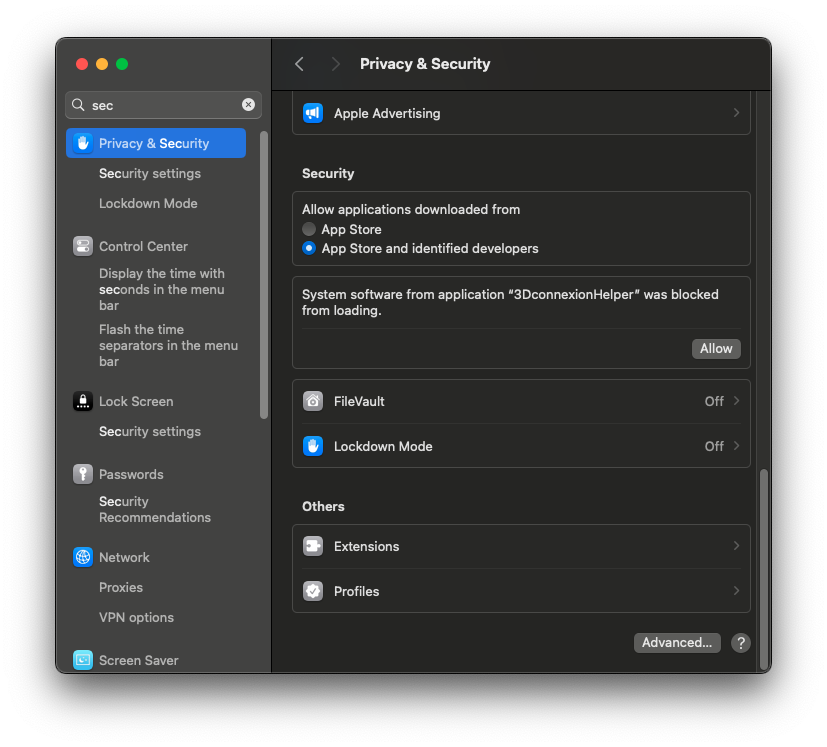

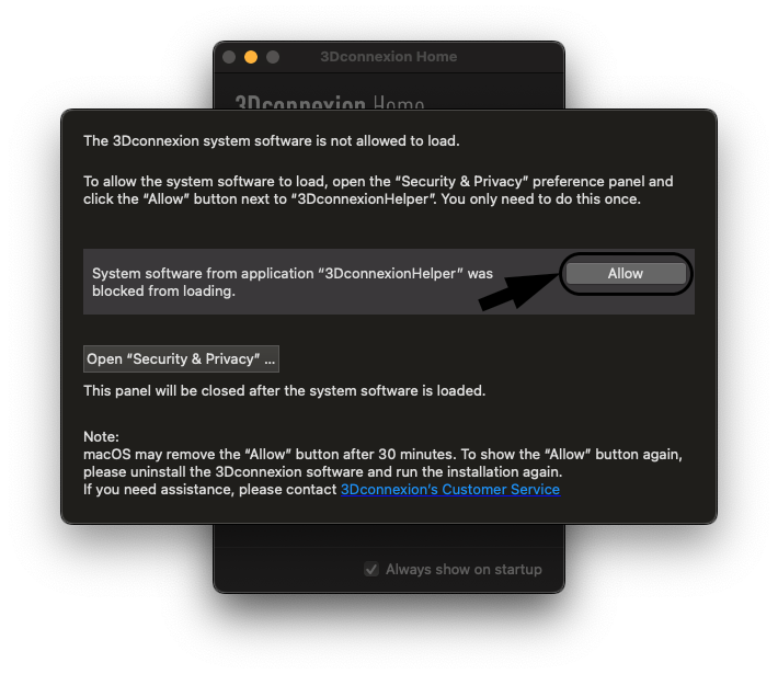

For macOS 14 (Sonoma) or Earlier:
  1. After installation is complete, you will see two prompts with information about an extension requiring to be enabled. A system information “System Extension Blocked” with a house icon and a more detailed panel overlayed of “3D Mouse Home”.
  2. Open System SettingsPrivacy & Security.
  3. Scroll down to find the message: “System software from the application ‘3DconnexionHelper’ was blocked from loading.”
  4. Click the Allow button.
