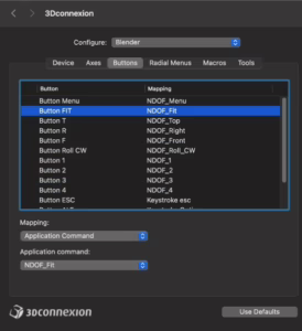

  • The “NDOF Button” commands are already pre-assigned. Each button has a specific command, like “NDOF_1”.
  • The commands can also be assigned to other buttons (the names of the button and of the command don’t need to match), so for example the CadMouse Middle Mouse Button could be mapped to “NDOF_1”. One command can also be assigned to multiple buttons – in that case all these buttons will execute the same function in Blender. This is done in “System Settings” -> “3Dconnexion prefPane” -> “Blender” -> “Buttons”.
