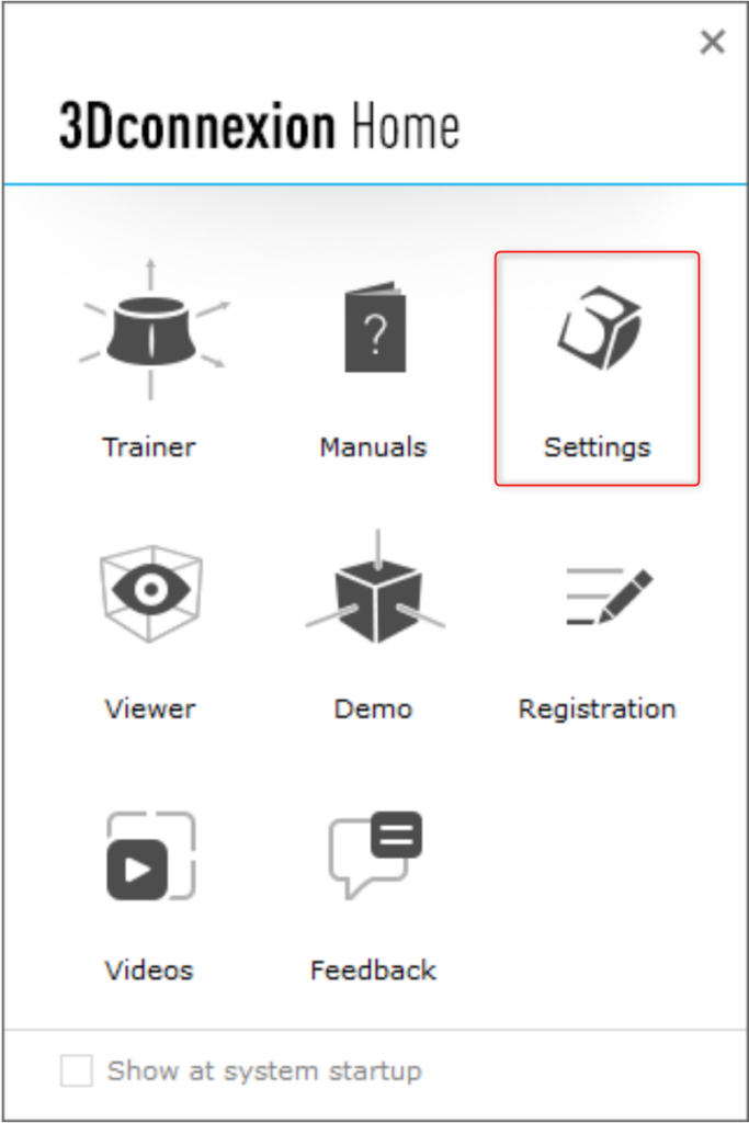

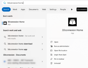

  1. Go to Windows Search and type 3Dconnexion Home

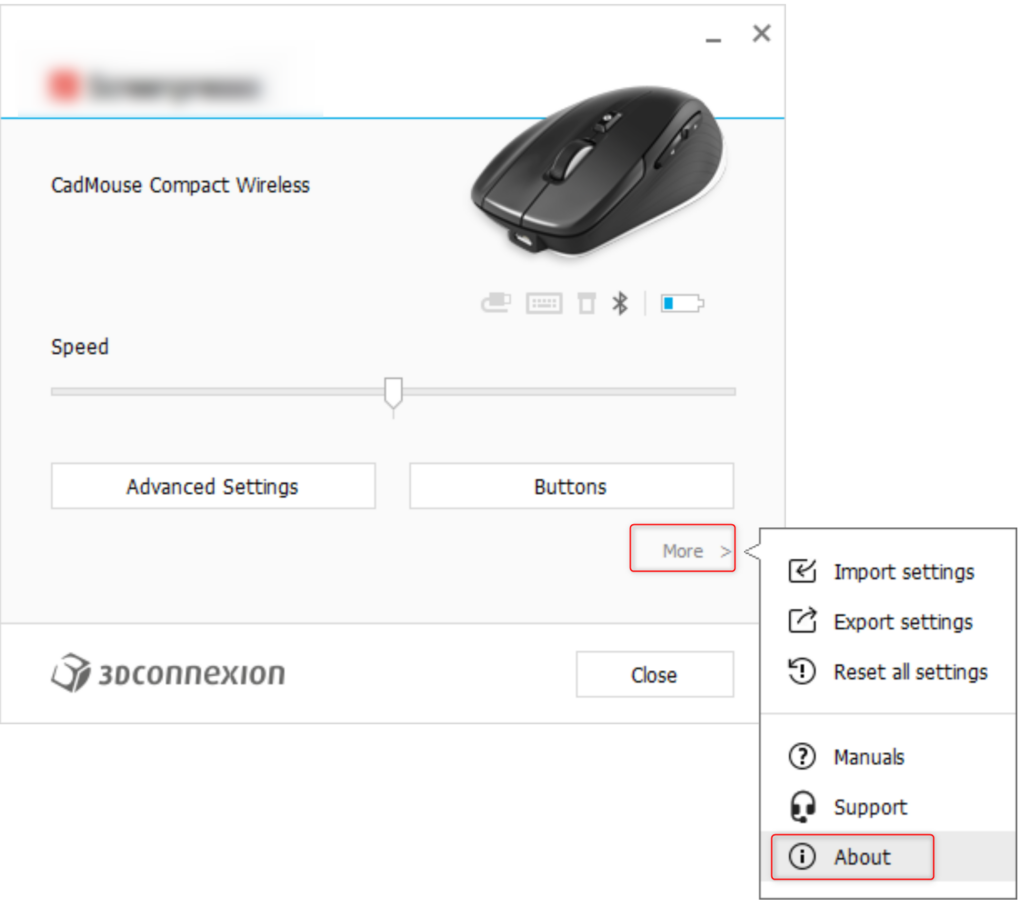

  2. Select Settings
  3. Go to More and About

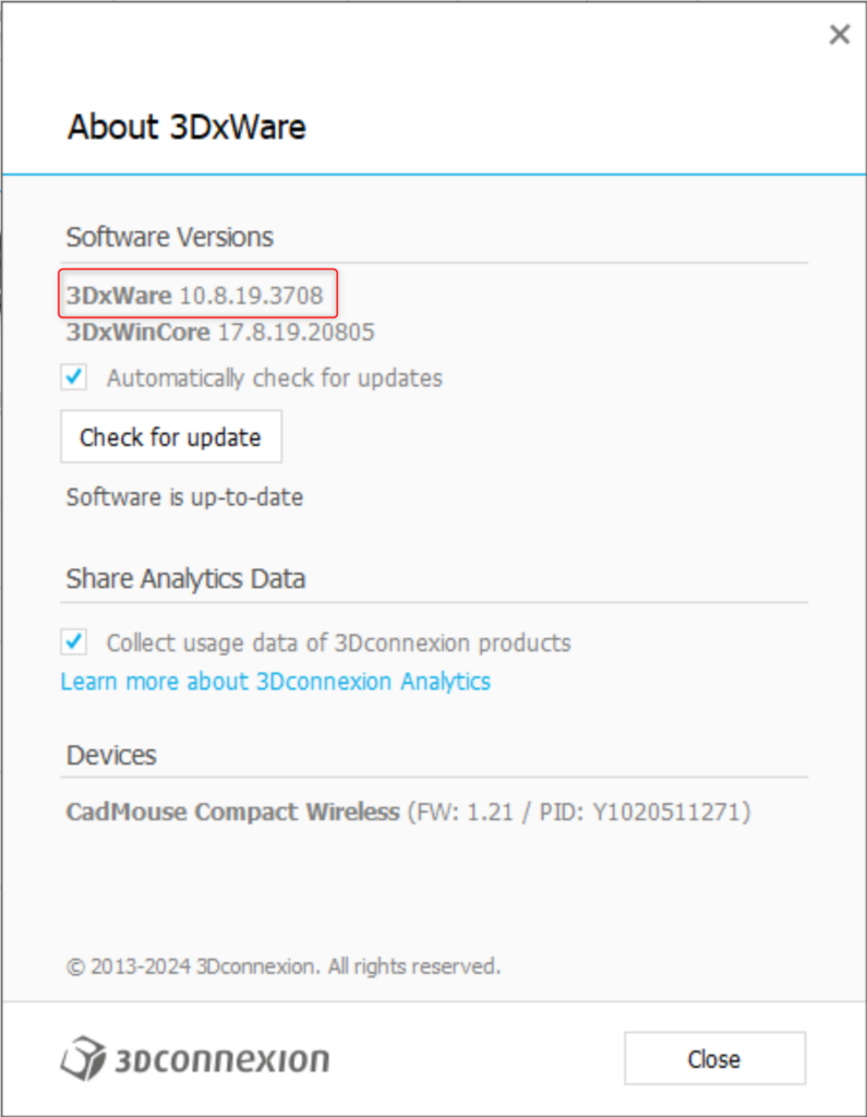

  4. On the top you will see 3DxWare driver version

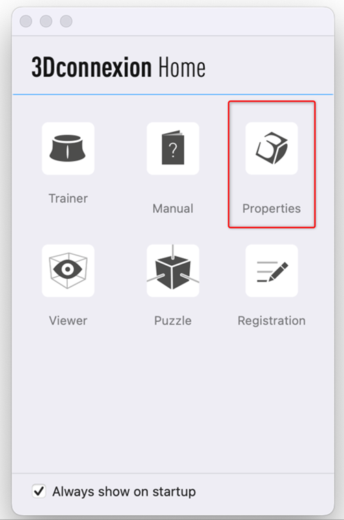

  1. Go to Spotlight Search and type 3Dconnexion Home
  2. Select Properties

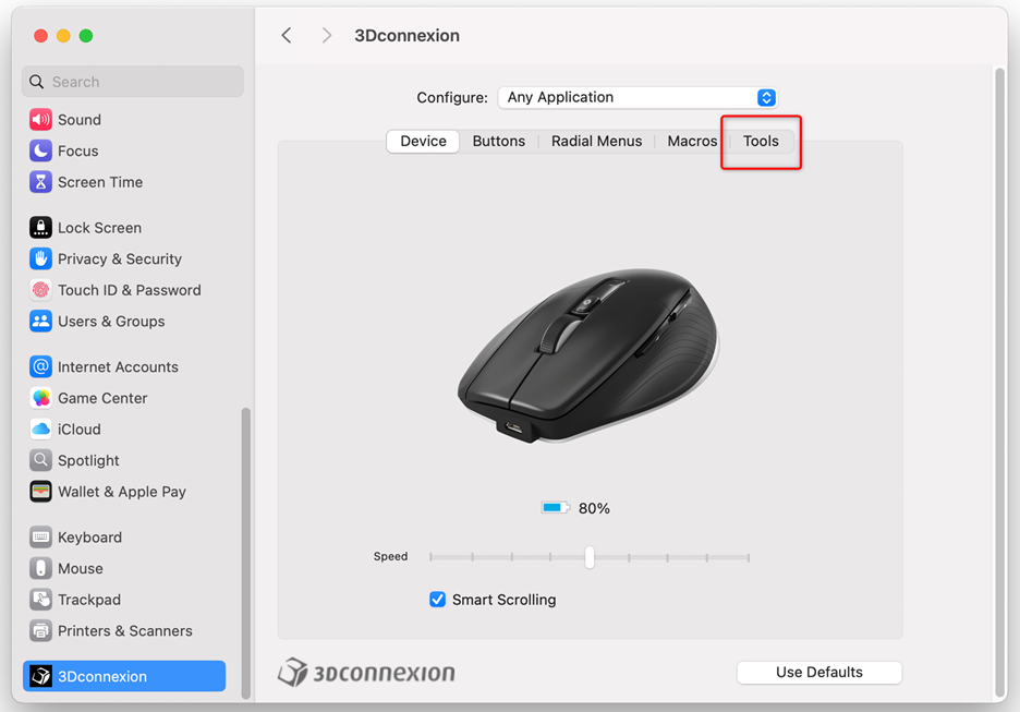

  3. Go to Tools
  4. On the top you will see the 3DxWare driver version
