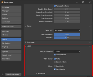

How to access 3Dconnexion settings inside Blender?
  1. Click «Edit» button on the ribbon and select «Preferences«
  2. Select the «Input» category and scroll to the «NDOF» tab at the bottom of the window. Here, you can configure most settings related to the SpaceMouse.
Is it possible to map Blender commands to the buttons on my 3Dconnexion devices?
Yes, it is possible with the use of the “NDOF Button” feature.
For guidance on how to use “NDOF Button”, please refer to separate articles:
How do I enable Fly Mode?
Blender 4.5:
  1. Under “NDOF Preferences”, set «Navigation mode» option to «Fly«
Blender 4.4 and previous:
  1. Under “NDOF Preferences”, set «Navigation» option to «Free«
  2. Deselect all axes in the «Invert Axis Pan» and «Orbit» fields, to ensure the reversal of axes is disabled for a true Fly Mode experience
How do I enable “Object Mode”?
Blender 4.5:
  1. Under “NDOF Preferences”, set «Navigation mode» option to «Object«
Object Mode is the default navigation method in Blender, but if you need to reenable it:
  1. Under “NDOF Preferences”, set «Navigation» option to «Orbit«
  2. Select all axes in the «Invert Axis Pan» and «Orbit» fields, to ensure the reversal of axes is enabled
CadMouse: How to use QuickZoom in Blender?
For proper experience using QuickZoom, it needs to zoom to the mouse cursor. To enable this behavior:
  1. Go to “Navigation” -> “Zoom” tab
  2. Enable the «Zoom to Mouse Position» setting
  3. Now you can use the CadMouse thumb buttons to QuickZoom
