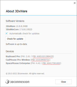

If your device is connected to your Windows computer, the serial number (PID) is shown in the “About” panel of the driver (3Dconnexion Home > Settings > More > About):
