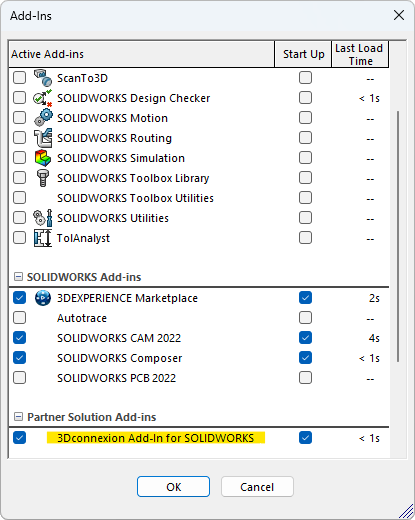

In case the driver could not connect to the Add-In for SOLIDWORKS the 3Dconnexion devices will not work.
In order to resolve the situation:
  1. Ensure the “3Dconnexion Add-In for SOLIDWORKS” was installed during installation of the driver
  2. Ensure the “3Dconnexion Add-In for SOLIDWORKS” is Active in SOLIDWORKS under “Tools > Add-Ins”
SOLIDWORKS AddIns
