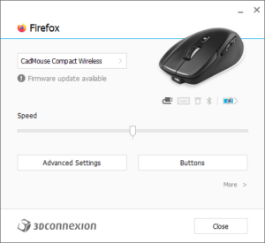

A notification will be displayed under the name of the device if a firmware is available (if you don’t see your device, please connect it via cable). See pictures below:
Clicking on the notification in the settings window starts the firmware update tool.
Please follow the instructions and click on Update.
