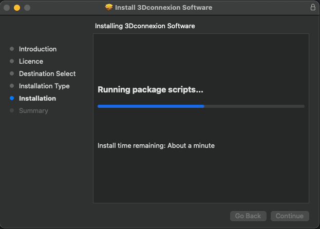

Possible reason for this issue: If your installation is stuck, it might be caused by improper uninstallation of 3Dconnexion driver, likely by dragging the 3Dconnexion folder to the trash. In the future, please use the „Uninstall 3Dconnexion Driver“ file  to properly uninstall the driver.
If using 3DxWare for macOS version 10.8.5 or older you may find your installation process being stuck in this situation:

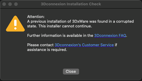

If using 3DxWare for macOS version 10.8.6 or newer, this warning message may be displayed:

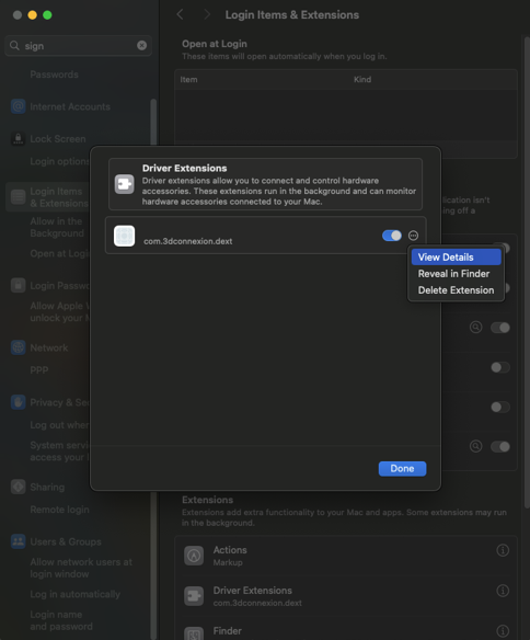

SOLUTION 1A (for macOS 15.0 and newer)
To resolve the problem, please follow these steps:
  1. Go to System Settings > Login Items & Extensions.
  2. Delete the 3Dconnexion extension (click the three dots next to the extension and choose “Delete Extension”, see screenshot below)
  3. Reboot your system to complete the process.
  4. Install the latest version of 3DxWare from our website
SOLUTION 1B  (for macOS 14 or older)
  1. Force quit the installer by pressing [Command] + [Option] + [Esc] on your keyboard.
  2. Restore the 3Dconnexion folder from the Trash (right-click and select “Put Back”).
  3. Note: Do not rerun the installer at this stage.
  4. Run “Uninstall 3Dconnexion Driver” inside the 3Dconnexion folder.
  5. Reboot your system to complete the process.
  6. Install the latest version of 3DxWare from our website
If you encounter any further issues, please contact our Technical Support team
