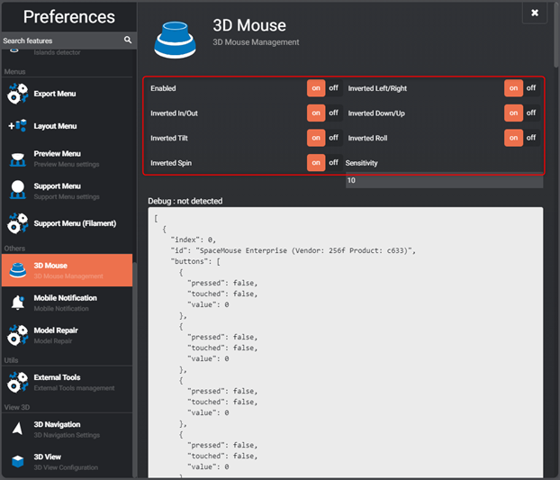

Lychee Slicer uses Target Camera navigation by default, which inverts all axes compared to Object mode navigation. To achieve a more intuitive and consistent experience, we recommend reversing all axes to match Object mode behavior.
Suggested SpaceMouse settings for Lychee Slicer:
Enable “Object Mode”
  1. Go to the settings for the SpaceMouse (File > Preferences > 3D Mouse)
  2. Activate the options: Inverted In/Out, Inverted Tilt, Inverted Spin, Inverted Left/Right, Inverted Down/Up, Inverted Roll
