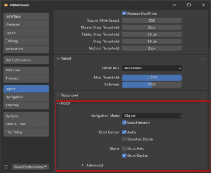

Since Blender version 4.5, the configuration process and the Preferences UI was simplified. For the best experience, use the latest Blender version: Download — blender.org
How to access 3Dconnexion settings inside Blender?
- Click « Edit » button on the ribbon and select « Preferences«
- Select the « Input » category and scroll to the « NDOF » tab at the bottom of the window. Here, you can configure most settings related to the SpaceMouse.

How do I enable “Fly Mode”?
Blender 4.5:
- Under “NDOF Preferences”, set « Navigation mode » option to « Fly«
Blender 4.4 and previous:
- Under “NDOF Preferences”, set « Navigation » option to « Free«
- Deselect all axes in the « Invert Axis Pan » and « Orbit » fields, to ensure the reversal of axes is disabled for a true Fly Mode experience
How do I enable “Object Mode”?
Blender 4.5:
- Under “NDOF Preferences”, set « Navigation mode » option to « Object«
Object Mode is the default navigation method in Blender, but if you need to reenable it:
- Under “NDOF Preferences”, set « Navigation » option to « Orbit«
- Select all axes in the « Invert Axis Pan » and « Orbit » fields, to ensure the reversal of axes is enabled
