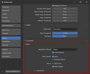

- Click “Edit” button on the ribbon and select “Preferences“
- Select the “Input” category and scroll to the “NDOF” tab at the bottom of the window. Here, you can configure most settings related to the SpaceMouse.

Blender 4.5:
- Under “NDOF Preferences”, set “Navigation mode” option to “Fly“
Blender 4.4 and previous:
- Under “NDOF Preferences”, set “Navigation” option to “Free“
- Deselect all axes in the “Invert Axis Pan” and “Orbit” fields, to ensure the reversal of axes is disabled for a true Fly Mode experience
How do I enable “Object Mode”?
Blender 4.5:
- Under “NDOF Preferences”, set “Navigation mode” option to “Object“
Object Mode is the default navigation method in Blender, but if you need to reenable it:
- Under “NDOF Preferences”, set “Navigation” option to “Orbit“
- Select all axes in the “Invert Axis Pan” and “Orbit” fields, to ensure the reversal of axes is enabled
