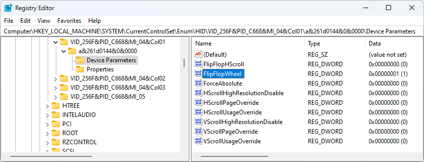

  1. Open the registry editor and browse to HKEY_LOCAL_MACHINE\SYSTEM\CurrentControlSet\Enum\HID
  2. Expand the folder (key) that matches the “VID ID” from Step 1 to “Device Parameters”

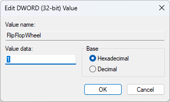

  3. Double-click the FlipFlopWheel DWORD and set the value from 0 to 1
  4. Reboot
