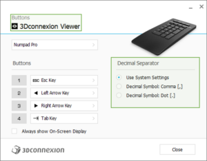

For every application, you can decide whether the decimal separator is automatically selected based on the system settings or manually choose your Comma or Dot preference:
In case you frequently need both separators, you can also adjust 3Dconnexion Keys 1-4 for a specific application (see above) or customize your Globally Programmable Buttons (see below):
More information can be found in the manual.
