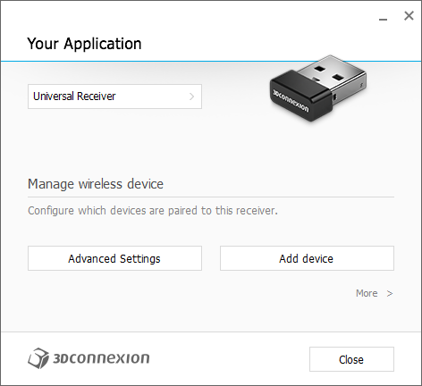

  • Make sure the latest driver is installed.
  • Connect the Universal Receiver to your computer.
  • Select the Universal Receiver from the properties panel, click on «Add Device» and follow the instructions.

You may also launch the pairing tool directly by clicking Start > Programs > 3Dconnexion > 3Dconnexion Pairing
